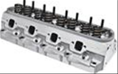

Like stated the power is in the heads intake and cam. Now you can do this the cheaper way. or you can go all out.
Were i am i can get a 302 From a late 80's mustang for about $300 thats 225Hp 300LB Torque. or you can just grab the heads.
Higher flow heads. the 1994 Explorer 302 came with GT40 Heads Stock the 1996+ came with GT40 P Heads they need different headers they flow alot better then stock late 80"s Mustang heads
Or you can go all out on a set of aluminum Heads that Flow Nice and are Light.

What is a good brand for heads and such. If possible a site/link to them or i can try find em. (Approx price to plz)

Here are some Trickflow heads http://www.trickflow.com/
This shop has tons of parts for many cars http://store.summitracing.com/

Ford Motorsports makes a whole grip of performance parts for 5L engines. Go to your local Ford dealer and grab a catalog.
Aftermarket manufacturers who seem to specialize in Ford performance off the top of my head:
TrickFlow Specialties(TFS): cylinder heads
Air Flow Research(AFR): cylinder heads
Comp Cams: camshafts
Edelbrock: intake manifolds, cylinder heads and anything else you can think of
Borla: exhaust
What you really need to do is join some Ford performance clubs online, pick up some magazines and get as many catalogs as you can and read, read, read! The 302 is almost as common as the sbC and is fairly easy to wrench on and parts are easy to come by. Like everyone else has said, the main areas to concentrate on are the cam, heads, intake and exhaust- remember your engine is nothing more than an air pump aided by combustion. Ask questions, do your homework and make the right decisions. Good luck with your hop-up.
